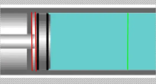

Consider a piston capable of pushing a long column of compressible gas, fluid, etc. Assume at time $t\leq0$ the piston is at rest and is at a distance of $0$ from a support serving mostly as a point of reference. Then at $t=0$ the piston is quickly accelerated to the right at a speed of $v_p$ (where the $p$ is for piston). Gas very far to the right will be uncompressed and still at rest, while gas near the piston will be moving at a speed of $v_p.$ By definition the boundary of the pressure discontinuity will be at a distance $tc$ from the piston, where $c$ is the speed of sound. Here, shown by the green line/circle below, there will be a pressure discontinuity of $\Delta P$:
piston
The distance between the red lines is $v_p t$, so this pictures assumes $c\sim 15v_p.$
It is important to realize that the green line moving at speed $c$ does not correspond to the speed of movement of any bulk gas. Rather, it is only an imaginary/virtual boundary indicating where the pressure discontinuity occurs, and also where the gas suddenly goes from being stationary to having a speed of $v_p$.
The force the piston has to exert on the gas is just upon the disturbed gas. It is $F={d\over dt}(p=mv_p),$ where $m$ is the mass of the disturbed gas and $p$ is its momentum. $=F=\dot{m}v_p+m\dot{v_p}=\rho A c v_p+0$ where $A$ is the cross sectional area of the tube and $\rho$ is the undisturbed density since we can use the gas mass to the left of the green line for gas back in time at $t=0$ to measure it instead of using the pressurized density and current time. But, we don't need to do this since the strain or compression factor is easy to compute. It's just $${\Delta V\over V}={A(ct-v_p t)-Act\over Act}=-v_p/c,$$ where $V$ denotes volumes. This strain corresponds to a pressure enhancement of $\Delta P$ only on the disturbed gas' left side. This gives the disturbed gas a force of
$$F=\Delta P A=\rho A c v_p$$
all of which goes into accelerating just the newly disturbed gas.
