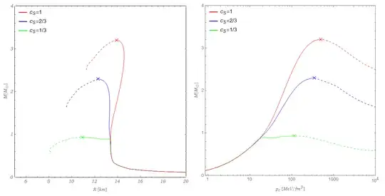

The following figure shows mass-radius and mass-central pressure curves for three different EoS. The data points of this figure correspond to solutions of the general relativistic structure equations of hydrostatic equilibrium (TOV equations). I matched those constant speed of sound EoS to a realistic low density curst EoS to get NS with realistic radii.
M-R and M-p_c curves
The crosses denote the maximum mass obtainable with the respective EoS and the dotted lines are unstable configurations. So we can clearly see that we need very stiff/high sound velocity EoS to get stable stars with masses above $2M_\odot$. The red line corresponds to NS with an EoS at the causal limit $c_s=1$. With such a stiff EoS we can get stable NS with masses up to $\sim 3.2 M_\odot$.
