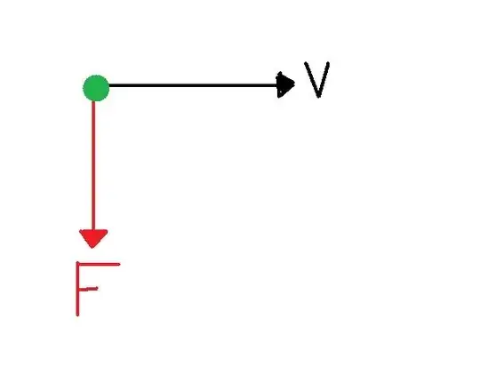

The green thingy is a ball whose velocity is initially along the black horizontal line. Now I apply a force along the red line, which is perpendicular to the black one. The green thingy is a ball whose velocity is initially along the black horizontal line. Now I apply a force along the red line, which is perpendicular to the black one.

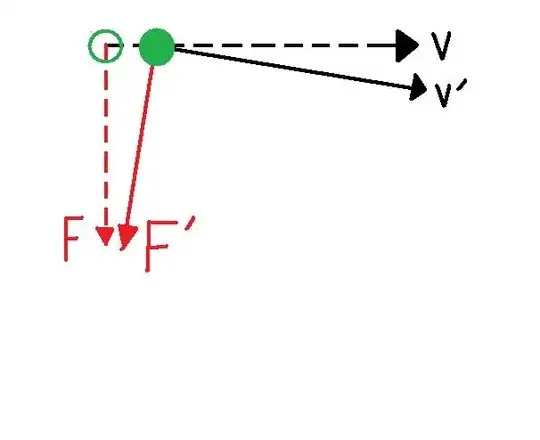

This causes the ball to turn ever so slightly downwards, so that it has a new velocity (v').
At the same time, I adjust the direction of my force so that I have a new force (F') which is perpendicular to v'.
dotted lines represent initial force and velocity, solid lines represent new force and velocity

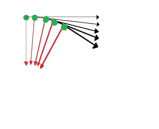

So the velocity keeps on changing direction, and I keep on adjusting the direction of my force so that the ball moves in a circle. At any point, the force is perpendicular to the velocity.
Red lines represent force, black ones represent velocity.
Notice that had there been no force, the ball would simply have moved in a horizontal straight line. The force 'forces' the ball to move in a circle. ;-) No force is required to 'balance' the centripetal force.
Also, in this example I would have to continuously change the direction in which I apply a force on the ball, so as to keep it moving in a circle. In your example, the gravitational force on the satellite is the centripetal force which keeps the satellite moving in a circle. It is always acting towards the center of the earth, so the 'adjusting' happens automatically as the satellite moves around the earth.
