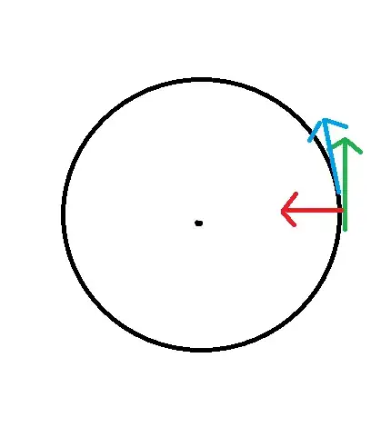

Now, note that velocity is a vector. In UCM (uniform circular motion), you have a body with constant speed, but the direction of its speed varies.
In the above diagram, the green arrow is the initial velocity vector. The blue arrow is the velocity after a split second. The red arrow is the acceleration vector required to change the velocity thus.
Now, by $\vec F=m\vec a$, we need a force to make this happen. So, which force is it? It depends.
If you are whirling the stone in a horizontal plane via a rope, this force is the tension force. If you are whirling it in a vertical plane, it is the combination of gravity and rope tension. It the ball is rolling in a bowl, it is the combination of gravity and reaction(normal) force. If this is a planet-satellite system, the force is just gravity.
A general term for this force is "centripetal force". CPF is a mixture of pre-existing forces, depending on the situation, as explained above. Using some calculus, we can prove that $\mathrm{CPF}=\frac{mv^2}{R}$, where $m$ is the mass of the particle, $v$ is the instantaneous velocity, and $R$ is the radius of curvature (just the radius in case of circular motion).
So it doesn't "come from" anywhere--it's not a new force. It's just a name for pre-existing forces when they create circular motion. That's all.
