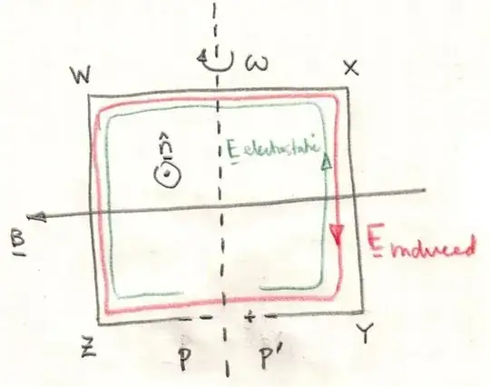

Rather than starting by looking at a motor I want to start with a consideration of a generator.
A conducting coil $WXYZ$ with a small gap in it is in the plane of the screen rotating as shown in the diagram with side $XY$ coming out of the screen and side $WZ$ going into the screen.
The unit vector $\hat n$ coming out of the screen and defines the positive direction.
Using Faraday’s law $\int_S \vec E \cdot d\vec s = - \frac {d}{dt} \iint_A \vec B \cdot d\vec a$ the induced E-field is predicted to be in a clockwise direction.
This is because $\vec B \cdot d \vec a$ is positive and the E-field line integral must be done in an anticlockwise direction when using the right hand convention.
The induced E-field moves charges in the wire which then produces an equal magnitude but opposite in direction electrostatic E-field in the coil.
Once the electrostatic E-field has been set up no current flows in the circuit and as there is no B-field resulting in the Poynting vector $\vec S$ being zero.
The integral $\int_S \vec E \cdot d\vec s$ is called the induced emf.
The electrostatic E-field has been introduced because it is a conservative field and so it can be used when applying Kirchhoff’s voltage law $\int_S \vec E \cdot d\vec s =0$.
Introducing a resistor across the gap means that a current $I$ will flow in the coil and a B-field is produced.
Note that in the diagram above this would mean that the induced current in the circuit will be in a clockwise direction.
That induced current will be producing a magnetic field inside the coil into the screen thus trying to reduce the increasing magnetic flux which is producing it – Lenz’s law.

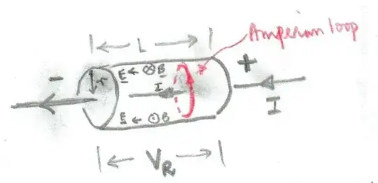

Consider the resistor as a cylinder.
Using Ampere’s law $\int_S \vec B \cdot d\vec s = \mu_o\iint_A \vec J \cdot d\vec a$ gives $B = \dfrac{\mu_oI}{2 \pi r}$.
The direction of the Poynting vector is the direction of $\vec E \times \vec B$ and for the resistor it points inwards towards the resistor.
The magnitude of the E-field is $\frac{V_R}{L}$ giving the magnitude of the Poynting vector as $\frac{V_RI}{2 \pi r L}$.
Since $2 \pi r L$ is the surface area of the resistor through which the energy is entering, the energy per second is $V_RI$ - as expected.
It is the next bit that I am not sure about and would value some comments about it.
For the electrostatic E-field and the associated B-field in the coil the Poynting vector points outwards.
Is this this the energy flowing out of the coil which then enters the resistor.
For the induced E-field and the associated magnetic field the Poynting vector points inwards and it always has the same magnitude as the Poynting vector associated with the electrostatic E-field.
Does the inward pointing Poynting vector associated with the induced E-field represent the flow of energy into the coil coming from the work done by the external forces making the coil rotate?
If what I have written above is correct then introducing a voltage source, with its positive terminal on the right hand side in the diagram above, in series with the resistor and the coil can result in one of three things happening.
The first is that current in the circuit carries on flowing in the same direction.
The analysis of the voltage source will be exactly the same as that for the resistor with the Poynting vector pointing inwards showing a power of $V_s I$ into the voltage source.
Applying KVL gives $V_B - V_S - V_R= 0 \Rightarrow V_B I = V_S I + V_R I$
Which can be interpreted as the power input to the generator $V_B I$ equals the power dissipated in the resistor and the voltage source.
The second possibility is that $V_S$ is such a value that no current flows in the circuit.
The last situation is when the voltage source $V_S$ is large enough to produce an E-field in the circuit external to it which is large to drive the current in the opposite direction.
One has gone from a generator to a motor and $V_B$ is sometimes called the back emf.
With this change of current direction the resistor has a Poynting vector inwards as does the coil but for the voltage source the Poynting vector is outwards.
Applying KVL gives $V_S - V_B – V_R = 0 \Rightarrow V_S I= V_BI +V_R i$
The power output from the voltage source equals the mechanical work done per second by the motor plus the power dissipated in the resistor.
