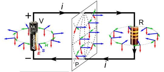

Apologies if you have read this Wikipedia Poynings Vector article, but it does contains lots of examples of the fields involved.
A DC circuit consisting of a battery (V) and resistor (R), showing the direction of the Poynting vector (S, blue) in the space surrounding it, along with the fields it is derived from; the electric field (E, red) and the magnetic field (H, green). In the region around the battery the Poynting vector is directed outward, indicating power flowing out of the battery into the fields; in the region around the resistor the vector is directed inward, indicating field power flowing into the resistor. Across any plane P between the battery and resistor, the Poynting flux is in the direction of the resistor.

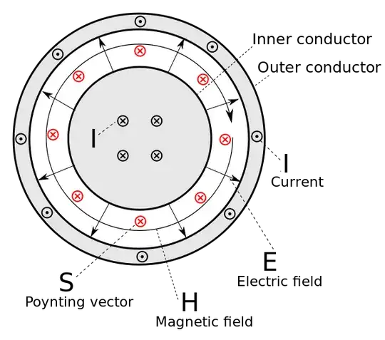

A coaxial cable, as an example.
Poynting vector in a coaxial cable, shown in red.
The Poynting vector contained inside the dielectric insulator of a coaxial cable is almost pointed parallel to the inner core wire axis (assuming no fields outside the cable and a wavelength longer than the diameter of the cable, including DC). Electrical energy delivered to the load is flowing entirely through the dielectric between the conductors. The electric field strength is almost nil, implying that only a small amount of energy flows through the conductors themselves, since the electric field strength is nearly zero. The energy flowing in the conductors flows radially into the conductors and accounts for energy lost to resistive heating of the conductor. Beyond the cable boundary, the magnetic fields of the outer and inner conductor negate each other, resulting in no overall energy flows outside the conductor.
This refers only to electromagnetic radiation, does it not?
Not only EM radiation. If there is some work done on the charges of a circuit (Joule effect for example), there is a flow of energy from the source. In a static configuration like a DC circuit, where the EM energy is constant everywhere, the flow equals the work done.
For a constant current flowing in a superconductor loop, the EM energy comes from the (static) magnetic field, but there is no work anywhere and no energy flow.
