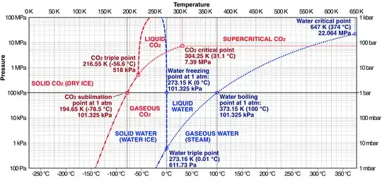

The answer lies in thermodynamics, specifically the triple point of the substance. If this occurs at a large pressure compared to STP, then it is possible for a material to sublimate. For instance, if you look at the phase diagram image below you can see that the sublimation point for CO$_{2}$ occurs at a lower temperature and pressure than its triple point. Whereas, water has a triple point at a much lower pressure than standard atmospheric pressure, so sublimation is less likely to occur under normal conditions (and in the absence of high energy photons or particles that can induce ablation).
phase diagram for water and carbon dioxide
Thus, if you continously add energy to solid CO$_{2}$, its first transition will be to a gaseous form not a liquid form under STP. If you increased the pressure on the system and then added energy, so long as the pressure is high enough then you can produce a liquid CO$_{2}$. The substance's chemical properties determine its critical and triple points and these have been well documented for most substances.
