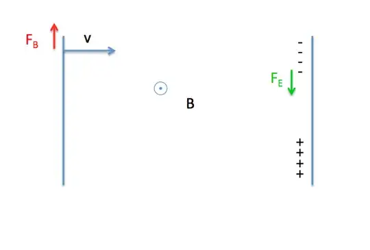

Maybe this diagram will help:
The charge carriers inside the wire will experience a force when they move relative to a magnetic field. This will cause them to be displaced in the wire - as they move, an electric field (emf) is induced in the wire that makes them want to "move the other way". When the two forces are balanced, the charges stop moving.
In an AC situation, current will keep flowing (see this question about antennas); in a DC situation, you just end up with a potential difference between the ends of the (open) wire.
The relationship between the amount of charge that flows, and the potential difference that is set up, is the capacitance of the wire. In the DC case, there will just be a transient charge flow (when the wire first starts moving) to set up the e.m.f. - once that has been established, no further current can (or needs to) flow as the forces are balanced.
