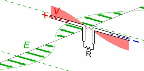

The following animated GIF is of an antenna called a dipole. It does not show transmission of an EM wave but rather it shows reception of an EM wave (the magnetic part has been omitted for clarity).
P.S. If the animation does not work in this comment, then please go to Antenna (Radio).
For a transmitter, you just replace the resistor $R$ with an alternating voltage source.
This type of antenna has a length which is related to the wavelength of the EM radiation and so a standing wave is produced – put another way – the system is at resonance.
Note how charges are stored at the ends of the antenna, so much so that at the ends of the antenna, which are voltage nodes, you can get a very nasty electric shock if you touch the end of a high-powered transmitting antenna. At the ends there are current nodes, which is because, as you quite rightly pointed out, there is no complete conducting circuit.
The centre of the dipole is a voltage node, but a current antinode. Current through a wire produces a magnetic field; magnetic field stores energy, so it is acting like an inductor.
