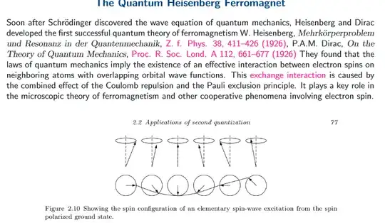

It is an experimental fact that atoms and molecules have magnetic moments. Also elementary particles with spin have magnetic moments as well as protons and neutrons.
It is not classical mechanics that will describe the behavior of atoms and molecules, but Quantum mechanics.
Quantum mechanical theoretical models of magnetism exist, and early on in the history of physics for ferromagnetism .
ferromodel
So they are not really new concepts, but as old as quantum mechanics.
