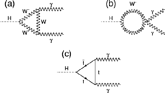

There is an aspect to this question that nobody seems to have addressed and that is, although the higgs (the 'radial' component of the field) is neutral, and therefore doesn't interact with the photon at 'tree level' we still see the decay $h \rightarrow \gamma \gamma$. This is because, roughly, by quantum effects a higgs will fluctuate into a particle/ anti-particle pair (electrons, quarks etc) which can they produce photons. So while the higgs does not strictly interact with the photon, at low energies we can parameterize a low-energy effective interaction where the higgs does interact with the photon. This is diagrammatically expressed in the Feynman diagrams: higgs to gamma gamma
which I have borrowed from http://resonaances.blogspot.com/2012/07/h-day-3-how-to-pump-up-higgs-to-gamma.html.
