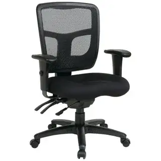

I've been wondering for a while... Why do most wheeled office chairs have 5 wheels?
a five wheeled office chair
My guess would be that while stability vs. simplicity results in 4 legs, adding mobility to the equation may result in the need for 5 wheels.

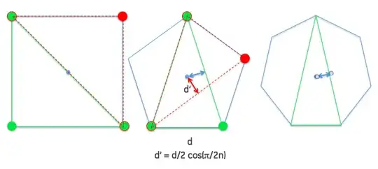

But there is another important factor (tip of the hat to my daughter for this concept): when the floor is uneven, a chair will be not be supported by all its legs - it will "wobble". Now if you have four legs, this wobble will happen along one of the diagonals of the square, and this line will be below (or very close to) the center of gravity. That makes the energy needed to go from one side to the other very small. When you have five legs, the center of gravity is always displaced relative to the line of support. So five legs provide greater stability on an uneven floor. As you add more legs, the "diagonal of support" gets close to the center. Even numbered regular polygons always have the potential of having the line of support going through the center, making them the worst choice (incidentally this shows that a trapezoidal arrangement of four legs is slightly better than a square... you will sometimes see that, and now you know why).

I don't know the history, I am just speculating. The chair in the picture has features that you don't find on a typical 4 point chair: It has casters, it has a swivel seat, and it has a springy reclining back. All of these make the chair more likely to tip over without warning. Lets assume that you roll the chair forward so all the casters are rotated to the back, then lean back. At the moment that it tips onto the two back most casters, the base will swivel to the least stable orientation, and the casters will rotate to form a smaller circle. In a 4 point chair, the base can rotate from diamond to square, and the casters rotate to make the square smaller, with no warning. A rigid 4 point chair is very predictable, and yet we have all tipped them over. Add the swivel and casters and the chair becomes an unpredictable killer. To compensate, the base circle must be increased and/or the number of casters must be increased.
