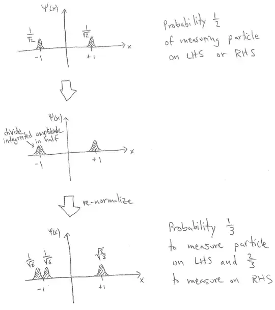

I'm struggling to understand a confusing feature of the Born rule in quantum mechanics, which is that the probability of an outcome appears to depend on how coarsely grained our measurements are. Consider the following normalized wave function in the position basis:
$$|\psi\rangle = \frac{1}{\sqrt{2}}|x=+1\rangle + \frac{1}{\sqrt{2}}|x=-1\rangle$$
Here the Born rule tells us that the probability of measuring a particle at each position is $\frac{1}{2}$. But what if our technology improves such that our measurement apparatus is able to discern a fine splitting around x=-1, such that the wave function is actually:
$$|\psi\rangle = \frac{1}{\sqrt{2}} |x=+1\rangle + \frac{1}{\sqrt{2}} \left(\frac{1}{2}|x=-1.01\rangle + \frac{1}{2} |x=-0.99\rangle \right)$$
Here is a picture that may help clarify what I'm referring to: enter image description here
The problem (or at least what is confusing to me) is that by merely decomposing a lump of amplitude into two equal parts we have changed the experimental outcome. Where before the probability was $\frac{1}{2}$ to measure the particle on the LHS or RHS, after we normalize the above state, it becomes:
$$|\psi\rangle = \sqrt{\frac{2}{3}}|x=+1\rangle + \frac{1}{\sqrt{6}}|x=-1.01\rangle + \frac{1}{\sqrt{6}}|x=-0.99\rangle$$
In other words the probability of measuring the particle on the LHS has been changed to 1/3 and on the RHS is now 2/3. The confusing thing is that all I have done is draw a line of demarcation between two halves of an amplitude distribution; I wouldn't have thought I was changing the physical state, but apparently I am because we are forced to re-normalized the state, resulting in different course-grained experimental outcomes.
Am I doing something wrong, or is this just a weird feature of quantum mechanics? If it is just a weird feature of quantum mechanics, how is it that it is not actually inconsistent, given that I merely used formalism to re-label two halves of a lump of what is otherwise the same amplitude distribution?

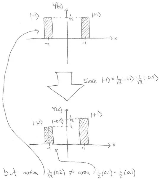

EDIT Adding the picture below which hopefully more succinctly illustrates the confusion:

So lets look at your example. It's actually 100% like the hydrogen example in the math, so make you understand that example, where every $\frac{1}{\sqrt 2}$ and $\frac{1}{2}$ came from and why.
So first we need a notation. I will use $|[a,b)\rangle $ for the state $\Psi_{[a,b)}$ that sends $x$ to $\Psi_{[a,b)}(x)=0$ if $x\notin[a,b)$ and sends $x$ to $\Psi_{[a,b)}(x)=\frac{1}{\sqrt{b-a}}$ if $x\in[a,b).$ Note that these states have unit norm. And we shall use the notation $x\mapsto\Psi_{[a,b)}(x)$ as another way to denote a function.
Next we define our operators. The coarse grained operator will be denoted $LR$ and we can define it by
$$LR:[\Psi=(x\mapsto\Psi(x))]\mapsto \left[LR\Psi=\left(x\mapsto[(LR\Psi)(x)=\frac{x}{|x|}\Psi(x)]\right)\right].$$
Note that this a perfectly well defined operator and in particular $\Psi_{[a,b)}$ is an eigenvector with eigenvalue $-1$ if $a\lt b\leq 0$ and $\Psi_{[a,b)}$ is an eigenvector with eigenvalue $+1$ if $0\leq a\lt b.$ And the size of the subspace is huge for each eigenvalue. This is a very very coarse operator. But it can separate things on the left from things on the right. And you can instead make finer operators such as $ABC$ if you want to resolve things better. We can define $ABC$ as follows:
$$ABC:[\Psi=(x\mapsto\Psi(x))]\mapsto \left[ABC\Psi=\left(x\mapsto[(ABC\Psi)(x)=\frac{x+1}{2|x+1|}\Psi(x)+\frac{x}{2|x|}\Psi(x)]\right)\right].$$
This is also a perfectly fine operator. It has eigenvalues $-1,$ $0,$ and $+1$ and in particular $\Psi_{[a,b)}$ is an eigenvector with eigenvalue $-1$ if $a\lt b\leq -1$ and $\Psi_{[a,b)}$ is an eigenvector with eigenvalue $+1$ if $0\leq a\lt b$ and $\Psi_{[a,b)}$ is an eigenvector with eigenvalue $0$ if $-1\leq a\lt b\leq 0.$
Clearly we could make operators that are even finer. But also keep in mind that each operator has a giant eigenspace associated with each eigenvalues, so just like the energy of the hydrogen atom we don't know the state if the subject just by stating the state of the measurement device. That's what is means to make a coarse measurement. And it's very common, it is called having a degenerate eigenvalue.
If you followed these steps you would have no questions, zero questions. So what issue are you having? You didn't do the above. Instead, you made a large number of very serious errors, including but not limited to:
  • You act as if your initial state is determined by your operator, it isn't.
  • You try to compute with some numbers instead of finding eigenspaces and doing projections. And you don't get your numbers correctly.
  • You look at areas under curves instead of areas under squares of curves.
  • You literally refuse to write the actual correct wavefunctions, operators and so forth.
If your subject state is originally $\Psi=\frac{1}{\sqrt 2}\Psi_{[-1.2,-0.8)}+\frac{1}{\sqrt 2}\Psi_{[0.8,1.2)}$ then please do verify that it is of unit norm, and that it sends $x$ to $\sqrt{5/4}$ when $x\in[-1.2,-0.8)\cup[0.8,1.2)$ and sends $x$ to zero otherwise. Then please verify that $\Psi_{[-1.2,-0.8)}=\frac{1}{\sqrt 2}\Psi_{[-1.2,-1.0)}+\frac{1}{\sqrt 2}\Psi_{[-1.0,-0.8)}.$
Now under the coarse operator $LR$ we get the final states of the detector are $|L\rangle$ and $|R\rangle.$ And under the fine operator $ABC$ we get the final states of the detector are $|A\rangle,$ $|B\rangle,$ and $|C\rangle.$
Thus if the initial state of the subject is $\Psi=\frac{1}{\sqrt 2}\Psi_{[-1.2,-0.8)}+\frac{1}{\sqrt 2}\Psi_{[0.8,1.2)}$ then since $\Psi_{[-1.2,-0.8)}=\frac{1}{\sqrt 2}\Psi_{[-1.2,-1.0)}+\frac{1}{\sqrt 2}\Psi_{[-1.0,-0.8)}$ we get
$$\Psi=\frac{1}{\sqrt 2}\Psi_{[-1.2,-0.8)}+\frac{1}{\sqrt 2}\Psi_{[0.8,1.2)}$$
and $$\Psi=\frac{1}{\sqrt 2}\left(\frac{1}{\sqrt 2}\Psi_{[-1.2,-1.0)}+\frac{1}{\sqrt 2}\Psi_{[-1.0,-0.8)}\right)+\frac{1}{\sqrt 2}\Psi_{[0.8,1.2)}$$
The first way of writing it, writes it entirely in terms of eigenvectors of $LR$ so you can see right away that if we measure it in terms of $LR$ we get it in state $\Psi_{[-1.2,-0.8)}\otimes|L\rangle$ 50% of the time and in state $\Psi_{[0.8,1.2)}\otimes|R\rangle$ 50% of the time.
But if we write it that second way it is terms of common eigenvector of both operators so we could see both measurements equally well. For coarse one sends it to $\left(\frac{1}{\sqrt 2}\Psi_{[-1.2,-1.0)}+\frac{1}{\sqrt 2}\Psi_{[-1.0,-0.8)}\right)\otimes|L\rangle$ 50% of the time and in state $\Psi_{[0.8,1.2)}\otimes|R\rangle$ 50% of the time.
And for the fine one it sends it to$\Psi_{[-1.2,-1.0)}\otimes|A\rangle$ 25% of the time, $\Psi_{[-1.0,-1.2)}\otimes|B\rangle$ 25% of the time, and to $\Psi_{[0.8,1.2)}\otimes|C\rangle$ 50% of the time.
This is all the physics. Make sure you understand the physics. Make you understand the math. And I tried to make it 100% look like your picture, except doing it correctly by having my notation always express things in terms of unit vectors to make the probabilities easy to compute. The wavefunction is zero or $\sqrt{5/4}$ every where before the measurement and it is different after the measurement

The problem is that the wave function should not be:
$$\frac{1}{\sqrt{2}}|x = +1\rangle + \frac{1}{\sqrt{2}} \left( \frac{1}{2}|x = -1.01 \rangle + \frac{1}{2} |x = -.99 \rangle \right) $$
but $$\frac{1}{\sqrt{2}}|x = +1\rangle + \frac{1}{\sqrt{2}} \left( \frac{1}{\sqrt{2}}|x = -1.01 \rangle + \frac{1}{\sqrt{2}} |x = -.99 \rangle \right). $$
