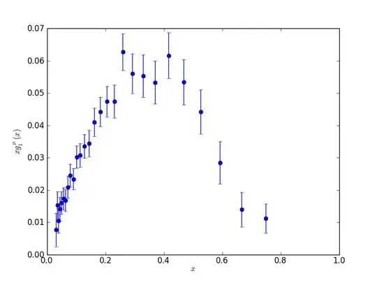

It turns out (perhaps unsurprisingly) that this last case is most relevant for a real proton. Now, I couldn't find the picture I really wanted to illustrate this, but I did get to make the following graph using polarized structure function data from SLAC-143, and it makes a similar point.
Polarized structure function from SLAC-143
You can see that there's a wide bump centered around $x = \frac{1}{3}$. This indicates that the partons in the proton are most likely to be carrying a third of the proton's momentum each, and this is the sense in which one might say that there are 3 constituent particles. (Technically, because this is a polarized structure function, it's talking about the difference between particles with opposite spins. But the unpolarized equivalent would look roughly similar.)

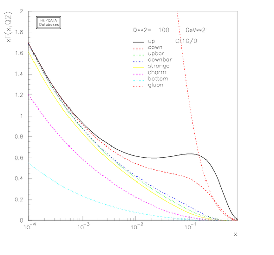

Taking into account all the data that has been collected over the last 40 years or so, the current PDFs for the proton look like this:
Graph of PDFs
As you can see, this combines some of the different features I discussed above. Most notably, there's a bump around $x = \frac{1}{3}$, and it's twice as large for up quarks as for down quarks, which means that there 2 valence up quarks and 1 valence down quark. But there is also a sharp rise in all the PDFs as you go to very small $x$, which is kind of like a spike. It indicates that there are a very large number of partons carrying very small fractions of the total momentum.
