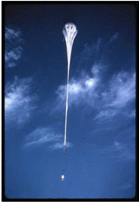

if we confine our discussion to weather balloons, like this one enter image description here
and assume the Ideal Gas Law, we can greatly simplify the problem. The balloon is limp; it is not under tension, and the pressure and temperature of the hydrogen or helium are the same as those of the surrounding air.
Assume that we put 2 grams of hydrogen (or 4 grams of helium) into the balloon. Depending on the local temperature and atmospheric pressure, this introduced gas will occupy some particular volume (the same for the specified weights of the two gases). The volume will be close to 22 litres since the molecular weight of hydrogen is 2.00, and the atomic weight of helium is 4.0)
Now the sneaky part. This volume will displace an equal volume of air, and that volume will have a mass of around 29 grams, since the air is at the same temperature and pressure as the balloon gas, and the "molecular weight" of air (a mixture of mainly oxygen and nitrogen) is around 29.0
As the balloon rises and the surrounding temperature and pressure changes, the volume of the gas will change, but the net lift per gram of gas will not change.
So a given balloon with a given load and mass of lifting gas will either have negative buoyancy, and sink until the ground takes part of the load, or will have positive buoyancy, and rise until the balloon becomes taut, or breaks from the cold...
