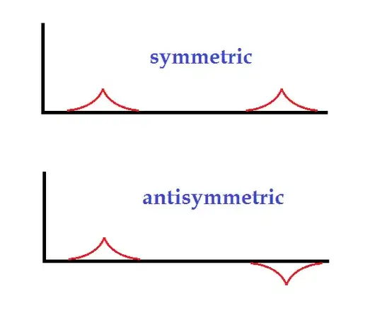

I already answered this question for the "real" case of two electrons with spin, but Lubos assures me that the OP meant for me to consider the case of no spin. I'm not sure what that would look like...if there is no spin, the electrons are bosons, and there is no Pauli exclusion principle. But Lubos further explains in his comment that we are to consider the "embedded" case of all electrons spin-up, where he means this case is "embedded" in the reality of arbitrary spin...we just restrict ourselves to looking at cases where the spin is up.
I've done that now, and it still doesn't look like anything recognizable from the other posted responses. I start by looking at the case of two hydrogen atoms with one electon. That's not too hard; and we do get something like what people are talking about, where there are two energy levels very close together:
One Electron and Two Atoms
The symmetric case is the true ground state, and a single electron in the ground state is equally shared between the two atoms. If you observe the electron in one or the other atoms, then it isn't in the ground state, it's in a superposition. If you find it at the left atom, then its the sum of the symmetric and antisymmetric states. If you find it at the right atom, it's the difference. Since the complex phase of two states precess at different rates, what is now the sum will later be the difference: so an electron found at the left will eventually show up at the right.
If you add a second electron, it's different. Both electrons can occupy the same state if their spins are opposite, but Lubos assures as we are to restrict ourselves to those cases when both electrons are spin up. That brings us back to the answer I posted earlier, for the arbitrary case where there are four energy levels. Only one of those cases allows both spins to be up...it is my State III. Technically, you cannot say that one electron is at A and the other is at B; you have to say that the electrons are in a superposition of states where A is here and B is there, and vice versa.
Either way, there is only one state. There are no superpositions like E1E2 - E2E1, as the OP stated and Lubos and Arnold went to town with. I just can't imagine what people are talking about.

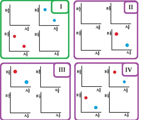

It is not clear to me that the answers posted so far address the OP's question. I find the OP does not have a proper representation system for the possible states. There are not two energy eigenstates but four: the true ground state, which is a singlet spin state, and three more states very close to the ground state, which are triplet states. He talks about a superposition of two energy eigenstates as though he has combined them to form an anti-symmetrized state...he seems to be trying to construct the singlet state from the energy states, but it doesn't work that way. You construct the singlet state from the position states...A-up/B-down, etc; and when you combine them properly, you get the singlet state which is in fact the lowest energy eigenstate.
All the fun happens when you get a system of two separated atoms in this singlet state. If you measure the spin of one, then the spin of the other must instantly become opposite. All the wonderful paradoxes that everyone likes to talk about flow from this situation. There are a couple of problems, however. It's not that easy to measure the spin of an electron. I don't care what anyone says: it's not that easy. And I don't think anyone knows of a way, even in principle, to prepare a system of two hydrogen atoms in the spin singlet state. I don't doubt that such pairs exist in nature: I just don't think there's any way to isolate such a pair and determine that it is indeed in the singlet state, at least not without destroying that state in the process.
I put up some sketches on my blog to show what the basis states look like for a system of two hydrogen atoms. I had some trouble getting it right, because it's a little confusing, but I'm pretty sure my final version is correct. This is the picture I came up with: it's supposed to be self-explanatory, but it would probably help to look at my blog. The singlet state is the one boxed in green; the triple states are in purple:
