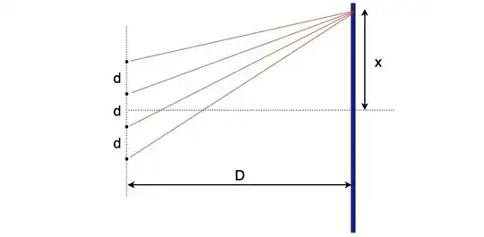

Let $D$ be the distance from the slits to the screen and $d$ the separation between 2 adjacent slits. The intensity pattern on the screen is then a function $I(x)$ of the on-screen position $x$ as shown in the figure below:
To see why some lines go missing, let's start with the general interference formula for N equidistant slits and light of wavelength $\lambda$ (see Sec.9.2 here for derivation and eq.(19) therein): $$ \frac{I_N(x)}{I_N(0)} = \left( \frac{\sin\left( N \frac{\pi d}{\lambda}\frac{x}{D}\right)}{N\sin\left(\frac{\pi d}{\lambda}\frac{x}{D} \right)}\right)^2 $$ For $N=2$ we get the regular 2-slit interference pattern,

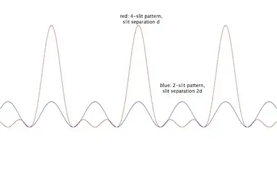

If we now compare the overall 4-slit pattern to the patterns produced by the outer and inner pairs of slits, we obtain something like the following: enter image description here Again we see "missing lines". But since the first 2 terms do not subtract, but actually add two independent 2-slit interference patterns, it must be that the missing peaks are due to the 3rd term:
The pattern produced by the outer pair of slits interferes destructively with that produced by the inner pair and wipes out non-overlapping 2-slit maxima.
