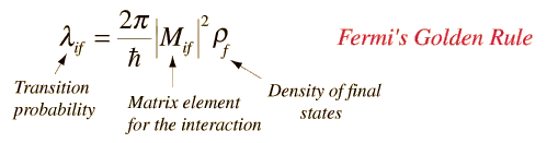

In general, electronic relaxation of an excited atom is nothing but a quantum mechanical transition from an initial to a final state. Therefore probabilities for different transitions (what you called paths) is determined by the rules of quantum mechanics.
The particular "law" that applies here is called Fermi's Golden Rule. In the related Hyperphysics page is says
In general conceptual terms, a transition rate depends upon the strength of the coupling between the initial and final state of a system and upon the number of ways the transition can happen (i.e., the density of the final states). In many physical situations the transition probability is of the form enter image description here

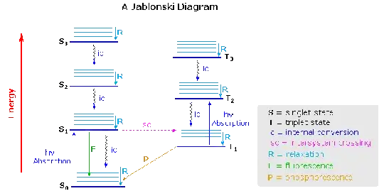

OK my previous answer was not cited correctly. I am trying to give you a good guess on what is going on when an electron returns to ground state. This is cited from another site, as I said I would just like to help you with clearing up this process with electron excitation.
http://chem.libretexts.org/Core/Physical_and_Theoretical_Chemistry/Spectroscopy/Electronic_Spectroscopy/Electronic_Spectroscopy%3A_Theory
You are asking specifically what determines whether they go 'straight' to ground state or step-by-step.
"A molecule that is excited can return to the ground state by several combinations of mechanical steps (see the picture). The deactivation process of fluorescence and phosphorescence involve an emission of a photon radiation. The wiggly arrows are deactivation processes without the use of radiation. The favored deactivation process is the route that is most rapid and spends less time in the excited state.If the rate constant for fluorescence is more favorable in the radiationless path, the fluorescence will be less intense or absent."
Here are the different types of deactivation (how the electron goes back to ground state on the picture):
This is here a citation from the original page just for your info:
"Vibrational Relaxation: A molecule maybe to promoted to several vibrational levels during the electronic excitation process.Collision of molecules with the excited species and solvent leads to rapid energy transfer and a slight increase in temperature of the solvent. Internal Conversion: Internal conversion is an intermolecular process of molecule that passes to a lower electronic state without the emission of radiation. External Conversion: Deactivation of the excited electronic state may also involve the interaction and energy transfer between the excited state and the solvent or solute in a process called external conversion. Intersystem Crossing: Intersystem crossing is a process where there is a crossover between electronic states of different multiplicity the singlet state to a triplet state (S1 to T1). Phosphorescence: Deactivation of the electronic excited state is also involved in phosphorescence. After the molecule transitions through intersystem crossing to the triplet state, further deactivation occurs through internal or external fluorescence or phosphorescence. A triplet-to-singlet transition is more probable than a singlet-to-singlet internal crossing. In phosphorescence, the excited state lifetime is inversely proportional to the probability that the molecule will transition back to the ground state. Since the lifetime of the molecule in the triplet state is large (10-4 to 10 second or more), transition is less probable which suggest that it will persist for some time even after irradiation has stopped. Since the external and internal conversion compete so effectively with phosphorescence, the molecule has to be observed at lower temperature in highly viscous media to protect the triplet state."
