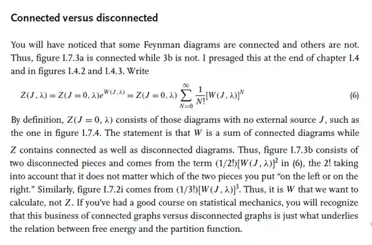

On page 47 of A. Zee's QFT in a Nutshell, he explains how disconnected Feynman diagrams can be built from lower-order connected diagrams:
I don't know how to understand formula $(6)$.
