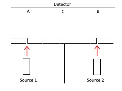

I'm wondering how that fits into the following modified double-slit experiment:
Modified double-slit experiment
Imagine two light sources emitting photons that are as coherent and equal as possible (same frequency, same polarization, etc). Each light source is placed before one of the slits, and there is a wall between the light sources, so if hole 1 is closed, only photons from source 2 can pass to the detector.

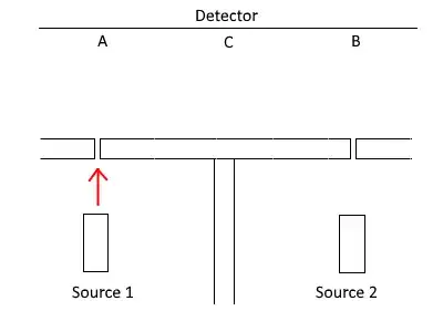

Let's define $\mathcal{H}_1$ as the Hilbert space of the quantum system where source 2 is off and only source 1 emits photons:

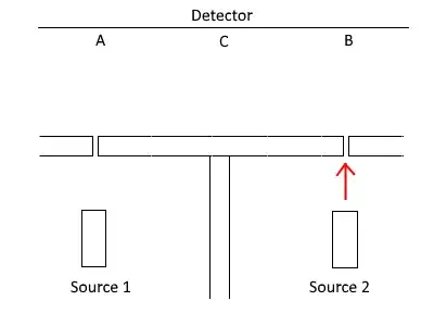

Similarly, $\mathcal{H}_2$ describes photons from source 2 and no photons from source 1:
In both systems, there is no interference pattern on the screen. In $\mathcal{H}_1$, we detect most of photons around the position A on the detector, and in $\mathcal{H}_2$ most of the photons land at position B.
Now, for the system $\mathcal{H}_c$ of the combined system, where both sources emit photons simultaneously, I assume that $\mathcal{H}_c = \mathcal{H}_1 \otimes \mathcal{H}_2$.
Is that correct so far?
Now, as far as I know, in $\mathcal{H}_c$ there should be an interference pattern of photons at the position C of the detector. The photons from source 1 interfere with those from source 2.
How can this interference be explained with respect to the tensor product? The wave functions of the photons from source 1 do not "live in" the same $\mathbb{R}^3$ as those from source 2, so how can they interfere?

Apparently, I got this wrong from the beginning. Two photons from different sources can interfere (if the experiment is set up appropriately, but it's very hard to set that up).
However, they don't interfere at the quantum mechanical wave function level, but at the level of the electromagnetic field.
