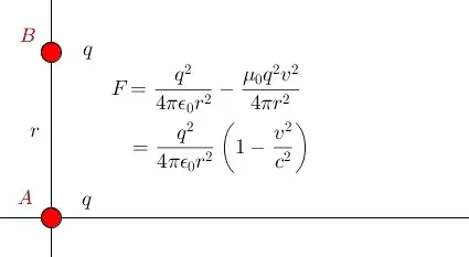

The two point charges are as below:
Then the Coulomb force between them is:
$$F_1=\frac{q^2}{4\pi\epsilon_0 r^2}$$
When the inertial reference frame moves left at $v$(or the point charges move right at $v$), then there will be magnetic field according to Biot–Savart law.
The Lorenz force between the two point charge in the vertical direction will be nonzero. The magnitude of the Lorentz force is:
$$f_L=\frac{\mu_0 q^2v^2}{4\pi r^2}$$
In wiki on Lorentz force, it says that:
The electric and magnetic fields are dependent on the velocity of an observer, so the relativistic form of the Lorentz force law can best be exhibited starting from a coordinate-independent expression for the electromagnetic and magnetic fields,[27] \mathcal{F}, and an arbitrary time-direction
Considering $F_1$ and $f_L$ have opposite directions and optical velocity $1/c^2=\mu_0\epsilon_0$, the magnitude of the force $F_2$ between the two charges becomes:
$$F_2=F_1-f_L= \left(1-\frac{v^2}{c^2}\right)F_1$$
Am I right?

Does this means Lorentz transformation for time is natural for an event involving both electric and magnetic laws without the need of considering special relativity?
It means that Lorentz transformations follow from electric and magnetic laws. It is how special relativity was discovered in the first place.
Your derivation looks correct. Maxwell's equations are not invariant under Newtonian transformations, only under Lorentz transformations.
Jan Hudec
  • 1,612
I would answer "yes". The Couloumb force $qE$ changes, and here's why: In frame at rest B=0, while in the moving frame (') B' is not zero. Since $E^2-B^2$ is Lorentz invariant: E' must be larger than E. (Which is the familiar relativistic squishing of fields--like in a transition-radiation-detector).
299792458
  • 3,214
JEB
  • 42,131
The answer is no, the Coulomb force between two point charges does not change, unless you change the distance between them. If the charges move in parallel, then the Coulomb equation no longer applies. You must use the Lorentz equation, instead. In other words, if the reference frame is moving and the charges are stationary, then the Coulomb equation applies. If the reference frame is stationary and the charges are moving, then the Lorentz equation applies. You can not apply both equations at the same time!
Guill
  • 2,573
