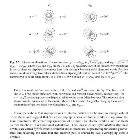

Also, the diagram below also shows how for different values of coefficients, the spatial orientation is changed.
orientation of orbitals
The snapshot above is taken from Principles of Physical Chemistry By Hans Kuhn, Horst-Dieter Försterling, David H. Waldeck
I haven't found any deduction as to how the coefficients determine the spatial orientation. I thought they are just amplitudes to go from the hybridised state to the pure orbital state; how can they direct the spatial orientation? In fact, why would they have to direct the direction of the orbitals. They are probability amplitudes, aren't they? I just want to know how to deduce that these probability amplitudes are actually influencing the direction. How can it be deduced mathematically?

The coefficients don't rotate anything, they are just numbers. What the diagram shows is that if you take two vectors:
Vectors
then you can get a vector $\psi$ in any direction you want using:
$$ \psi = c_1\psi_1 + c_2 \psi_2 $$
with the normalisation condition $c_1^2 + c_2^2 = 1$. For example:
$$ \psi = \frac{1}{\sqrt{2}}\psi_1 + \frac{1}{\sqrt{2}}\psi_2 $$
is at 45º. More generally:
$$ \psi = \sin(\theta)\psi_1 + \cos(\theta)\psi_2 $$
gives you a vector at an angle $\theta$ to the horizontal, and it's automatically normalised since $\sin^2 + \cos^2 = 1$.
The diagram is just showing this applies to the $2p$ orbitals. Combining $2p_x$ and $2p_y$ in different proportions gives an orbital at different angles.

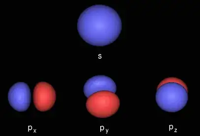

I honestly don't see why you're so mystified by this. Keep in mind that, in the end, you're adding up states which represent functions over real space, and these functions each have their own spatial dependence:
s, px, py, pz hydrogenic wavefunctions
(Image source)
The different colours represent different signs: blue is positive, red is negative. If you have a mixed wavefunction like, say, $$ \frac1{\sqrt{2}}\left(\psi_{2s}(\mathbf r)+\psi_{2p_z}(\mathbf r)\right) $$ then at $z>0$, where $\psi_{2p_z}(\mathbf r)>0$, the probability amplitude will increase, while at $z<0$ you have $\psi_{2p_z}(\mathbf r)<0$ so it detracts from $\psi_{2s}(\mathbf r)$ and the probability amplitude will decrease. The overall effect, then, is that the wavefunction's lump is pushed towards positive $z$. (Similarly, the orthogonal wavefunction $\tfrac1{\sqrt{2}}\left(\psi_{2s}(\mathbf r)-\psi_{2p_z}(\mathbf r)\right)$ is pushed towards negative $z$.
For the more general case of $sp^3$ mixing, with wavefunctions of the form $$\psi_{sp^3}(\mathbf r)= c_1\psi_{2s}(\mathbf r)+ c_2\psi_{2p_{x}}(\mathbf r) + c_3\psi_{2p_y}(\mathbf r)+ c_4\psi_{2p_{z}}(\mathbf r),$$ the $c_i$ act as probability amplitudes (in an abstract Hilbert-space view) but they also act as mixing coefficients between the different wavefunctions. Add some $\psi_{2p_{z}}$ and you push the orbital up; subtract some $\psi_{2p_{z}}$ and add some $\psi_{2p_{x}}$ and you push it down and forwards; and so on.
