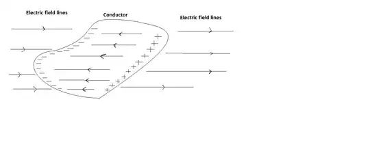

Refer to the pic below (drawn in MS Paint) enter image description here
When placed in external electric field, the electrons migrate to one side of the conductor and an electric field is created inside the conductor itself due to separation of positive and negative charges, as is evident from the pic. In case of conductors, this electric field is equal to that of the external electric field and hence neutralises the external field.
So the net field inside the conductor is zero.
