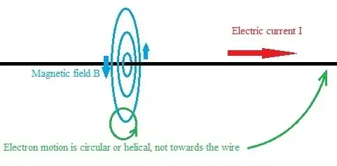

If you ask around about magnetic fields, you will read seemingly-authoritative articles which say magnetism is a consequence of length contraction. This is widely taught and is repeated in answers such as this one which talks about the magnetic force between current-carrying wires. I'm sure we're all happy with this force, which you can see described in the picture from Rod Nave's hyperphysics:
However note the concentric magnetic field lines around the wire. We know that a charged particle such as an electron will circle around these field lines, as per this depiction courtesy of Chegg homework help:
In addition we know that a positron will circle the magnetic field lines the other way. If the electron path is a left handed helix, the positron path is a right-hand helix. Or a circle, as per these pictures of an electron beam in a uniform magnetic field.
The length-contraction explanation for two wires moving together sounds fairly plausible. However there doesn't seem to be any way that length contraction in that linear wire can result in the opposite circular motion of electrons and positrons. The so-called explanations I've found are woeful, little more than smoke and mirrors and a rabbit from a hat. Would anybody care to have a crack at explaining how this happens? There will be a 100-point bounty to the least-worst answer.
How can length contraction result in electron circular motion in a magnetic field, and the opposite circular motion for a positron?
Edit: for clarification, see this drawing:
You're (hopefully!) gonna kick yourself. It's just because the electric-only Lorentz force is $q \vec E$ and therefore is opposite if the charge of the particle is opposite. If you replace those electrons and nucleons in wire-2 with positrons and antinucleons, then the force on the antiprotons is easily seen to be zero; then we boost into the reference frame of the positrons, and we see the exact same electric field due to wire-1, but the Lorentz force on the positrons points the opposite direction (repulsive) because like charges repel and opposite charges attract.
In general it has to be that way: whenever you perform this "boost into its frame to make the $\vec B$ field have no Lorentz force" trick on any electron, you find some $\vec E$ field which provides the equivalent force; if you replace the electron with a positron with the same velocity, necessarily the fields calculated from these "length-contracted currents" is the same, but the force is opposite, because the positron has opposite charge from the electron.

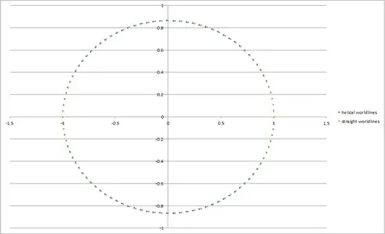

Pretty picture
Edit: because you expressed some doubt that there is a charge accumulation due to the helicity of the solenoid electrons, I actually wrote a quick Excel sheet which solved for the $r^0=0$ hyperplane of the Lorentz boost of the helices $[ct,\;r\cos(\omega~t+\phi),\;r\sin(\omega~t+\phi),\;\mu~s + \nu~t]$ versus $[ct, r\cos(\phi),\;r\sin(\phi),\;\mu~s]$. As you can see, the green charges (positive nuclei) appear right of the blue charges (electrons) for most of the curves, indicating a higher charge density on the left versus that on the right. So yes, this is a real and direct prediction of the Lorentz transform and no, you cannot shake it. Moreover, I am claiming that this is the effect which generates the force in the reference frame co-moving with the particle: the particle cannot feel the magnetic part of the electromagnetic force tensor in that reference frame and instead feels a "sideways" force purely due to the electric part, which can be analyzed classically as due to charge accumulation on one side of the ring of current.

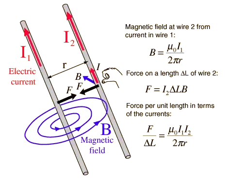

We aren't happy enough to not make comments and pass judgment, especially if you don't want to be wrong. So skip to the next quote if being totally right about the case of the wires and what's going on and why is not important.
The ones due just to the left wire, the thing Maxwell alone (without boundary conditions) does not predict?
It will feel a force orthogonal to the magnetic field depicted and also orthogonal to the velocity, but the actual motion will be affected by all forces on it, not just those forces.
