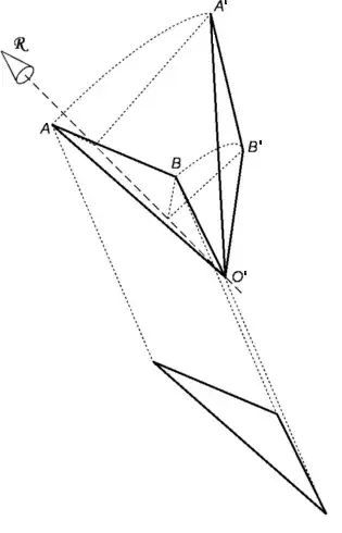

For a general displacement of a rigid body in 3D-space, you need to track the position of at least three non-collinear points fixed on that body. First, translate this body without changing it's orientation from it's initial position to an intermediate position which superimposes one of those three points you are tracking to it's final location. Let's call these intermediate points A, B and O, the final points A', B' and O' and we will superimpose O at O'. You now have two configurations of that body, one in it's original orientation but different position and the other in it's final configuration.
Now imagine a line R through O' which acts as an axis to rotate A around to A'. Any line which lies in the plane X that perpendicularly bisects segment AA' of triangle AO'A' will intersect O' and can be R. The angles AO'R and A'O'R are equal and some associated angel Φ of displacement moves A to A'. These three angles will have values that depend on the orientation of R that is used. However, any rotational displacement Φ, will not move point B to coincide with B'. Use a second plane Y that perpendicularly bisects segment BB' of triangle BO'B' and must also intersects O'. Likewise, angles BO'R and B'O'R are equal. Plane Y will contain all axes that can rotate B to B'. So the intersection of these two bisecting planes X and Y gives the line R common to both at the orientation needed to relate segments O'A and O'B in exactly the same way as it relates to segments O'A' and O'B'. Likewise, the angles AO'R and BO'R are respectively equal to angles A'O'R and B'O'R. The figure O'ABR can be rotated around R so that segments O'A and O'B come into the positions of O'A' and O'B' respectively with R retaining it's position unchanged. Thus a rotation around R gives use the needed displacement.

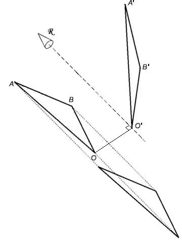

After finding the orientation of R, with the body back at it's initial configuration, translate the body in a parallel direction with R to an intermediate position, bringing point O to the perpendicular from O' on R. We now have the case where the displacement of a 3D rigid body is restricted to 2D-planar movement and all points of the body move in parallel planes.

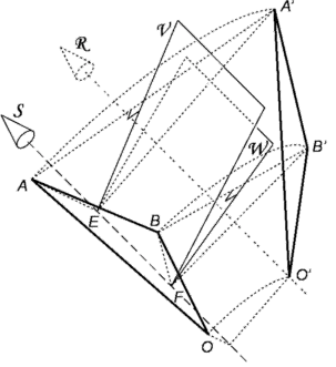

For a complete description of these 2D-displacements, you need to track the position of at least two fixed points on the body, say points A and B. Any displacement of these two points or of segment AB to superimpose segment A'B' can be done by a single rotation around a line S perpendicular to the plane of movement. Showing this is basically same as before except now we know the orientation of S but need to find it's position. Two planes V and W, perpendicular to the plane of movement, bisect segments AA' and BB' respectively and intersect in a line S. Let perpendiculars from point E on S intersect A and A', and perpendiculars from F on S intersect B and B'. Segments EA = EA', FB = FB', AB = A'B'. So figure AEFB is the same as figure A'EFB' and rotating AEFB around S brings it into the same orientation as A'EFB'. Since A is moved to A' then B must also be moved to B'. Thus line S is the screw axis.
