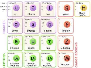

Is there any size of photon if so what is it?
The photon is an elementary particle among the others which form a basis for the standard model of particle physics.
elementary particles
The Standard Model of elementary particles (more schematic depiction), with the three generations of matter, gauge bosons in the fourth column, and the Higgs boson in the fifth.
The model encapsulates all the experimental data very successfully, and the size of these particles is considered zero, they are point particles.
And also which particle had smallest size / radius / volume considering all of the matter.
A composite particle, like a proton which is made up from three quarks and their dynamic exchanges, has a definite size, given the energy of the probing interaction.
Elementary particles are point particles.
String theory which is trying to extend the standard model and unify it with gravitation hypothesizes that elementary particles are vibrations on a one dimensional string, whose dimension is of order of the planck length, 16x10^-36meters, a very small length not measurable experimentally.
