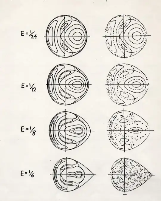

$\uparrow$ Fig. 1. Poincare maps in the $(y,\dot{y})$ plane with $(x,\dot{x})=(0,0)$ for various fixed energy-levels $E$ of the Henon-Heiles (HH) system. We consider below the outermost periodic orbit for $E=1/6$ and $E=1/12$.
