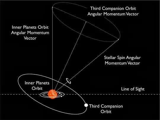

Enter image description here
Also text here
To measure the rotation of the star in Kepler-56, the authors looked at oscillation modes due to a combination of pressure and gravity waves inside the star. Certain pressure-dominated and gravity-dominated modes will split in a unique way depending on the inclination of the star’s rotation axis. The authors model the splitting of six modes to derive the star’s inclination. Because the planets transit, their inclination angle is very close to 90 degrees. Therefore, any angle different from 90 degrees for the star’s inclination is a direct measure of obliquity.
