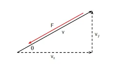

I find this type of question is always easier if you draw a diagram. The drag force $F$ acts in the opposite direction to the velocity so it looks like:
Drag
and the components of the drag force are:
$$\begin{align} F_x &= F \cos\theta \\ F_y &= F \sin\theta \end{align}$$
$\cos\theta$ is $v_x/v$ and $v = \sqrt{v_x^2 + v_y^2}$ so we get:
$$ F_x = F \frac{v_x}{\sqrt{v_x^2 + v_y^2}} $$
Since $F = -Cv^2$ we get:
$$ F_x = -Cv^2 \frac{v_x}{\sqrt{v_x^2 + v_y^2}} $$
and because $v = \sqrt{v_x^2 + v_y^2}$ this becomes:
$$\begin{align} F_x &= -C \left(v_x^2 + v_y^2\right) \frac{v_x}{\sqrt{v_x^2 + v_y^2}} \\ &= -C v_x \sqrt{v_x^2 + v_y^2} \end{align}$$
And likewise for $F_y$.
