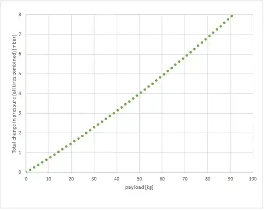

  1. This graph shows how much pressure is added by a specific payload put into the car. The car's net-weight is about 1,1tons. The initial pressure of all 4 tires was 3,20bar (absolute). How could I model and explain this quadratic-equation like behaviour? I would love to have an equation that I can give 80kg as input and then receive about 7mbar as output. (Tire is elastic; for the moment of change the behaviour is adiabatic I assume so we got p~1/V from pV=nRT; p=F/A; F=M*g; M increases and so does F, but A (between tire and street) does also change and so does V of the tire. But how exactly(well of coure more or less exactly, we don't know the exactly composition of the tire and neither do I want a too complex model of the tire)? The absolute values won't have to be true for this specific data, just the general behaviour. tire pressure vs car payload
  2. The change in pressure for the same weight on one of the front seats is higher. (70kg front is the same change in pressure like 80kg in rear seat) Pro Argument: The car's enginge is in the front, so it's like there is already more load, and when e.g. the first 50kg results in 4mbar pressure change, another 50kg leads to more than 4mbar change in pressure. But argument against: The weight is more well distributed between the front and rear tires, because the rear seats are like directly over the rear tires while the front seats are more in the middle of front and rear tires. This alone would therefore lead to a less increase in pressure. Maybe the first affect is dominant and the seconds just dampens the whole thing a little?
