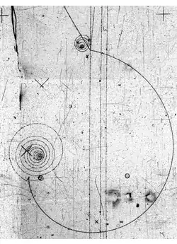

Having worked with elementary particles all my working life I can assure you that particles have a trajectory.
Here is proof
Another proof is the existence of accelerators which create the beams that we can scatter against targets, as in picture, or against each other and study the results statistically. That is how the standard model of particle physics was built up, studying trajectories.
Trajectories are saved by the HUP, the Heisenberg Uncertainty Principle, which given enough momentum can always be fulfilled as the bubble chamber picture shows. Within its bound lie the bound states of atoms , and there we speak of orbitals, not orbits.
Everything is quantum mechanical, and the HUP is the measure of whether classical concepts and mechanics are applicable or not. So in your example the electron can be generated in a small accelerator and approach with a known trajectory a potential well of an ion up to the point of closenes where the indeterminacy of the HUP destroys the concept of a trajectory and the probabilistic form will apply.

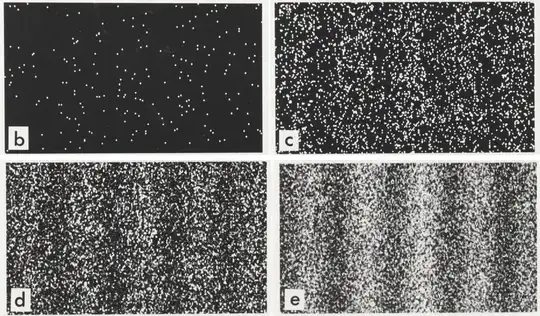

In classical physics we have always dealt with the motion of non-punctual objects as fluids and rigid bodies (let’s call them fields). The trajectory of those objects is clearly not a single line. However, by experience we notice that such fields have special symmetry points were all other points seem to move around. These points are known as the center of mass (or better, center of energy) and therefore, the trajectory of a field can be decomposed into two. One is the clear path of the center of mass and other is motion of every individual point around it. In quantum mechanics I always view particles as fields just as in classical mechanics. You can call these as probability density fields $\Psi(p)=|\psi(p)|^2$, but I prefer to call them THE “particle distribution”. Such a distribution governs the distribution of every other property of the particle.
Single point interation pattern of particles. By Dr. Tonomura and Belsazar Single point interation pattern of particles. By Dr. Tonomura and Belsazar
Now, if particles are volumetric, then why particle interaction with a screen builds up as single points like in the image above? Well, by the same reason one can empty an entire bathtub thru a single hole. In fact, we could drain an entire ocean from a small hole, if we could make that hole down to the center of earth and create some room there for it. Fluids have 2 characteristics that make them prone to do that: 1) If you remove some of the fluid in a particular point, disturbing they natural shape, it brings fluid from the vicinity to restore its original shape; 2) The bigger the gradient (removal) the faster it pours into that point.
Characteristic 2) is important because, it means that a fast passing particle will have a bigger change to pour all of its energy into a particular point before getting too far from it, if the value of its energy distribution is high enough at that point to allow for a big uptake. This means that the higher the value of the “fluid distribution” in a particular point, the higher the probability for the particle to strongly interact in that point, i.e. $\Psi(p)$ gives the probability density that a particle will (strongly) interact into a particular point.
