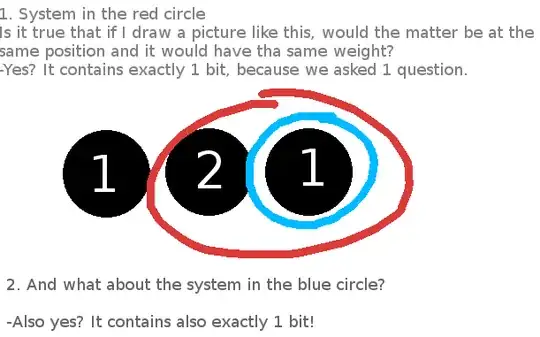

Subset paradox
I have read this answer which defines information as a number of (minimum) YES/NO question you have to ask to perfectly specify the object that carries the information. But this would mean that everything (including every subset or superset which is impossible, how shows the picture) carries the same amount of information - for example if only describeable physical quantities were position and weight, my question for everything could be: "Is it true that it is there and it weighs that?"Now, let's consider a closed system consisting only of three particles.
