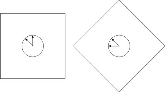

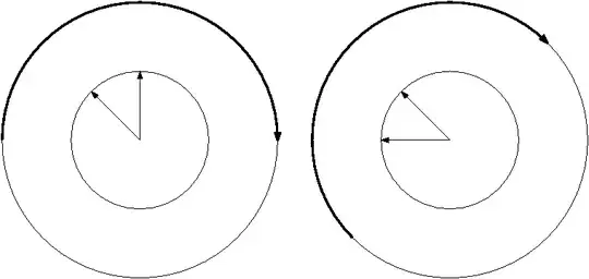

OK, I'm going to add an answer based on the possible duplicate and the other answer given. I'm going to assume we accept Gauss's Law here (which makes things much easier rather than trying to prove using Coulomb's law or Newton's theory of gravity from the duplicate answer). First, you need to appreciate the symmetry of the situation.
First off, we know that since the enclosed charge is zero that the electric flux through the enclosed Gaussian surface is zero. This does not help us determine the electric field--at all! It isn't until we reason that, through symmetry, that the electric field must be the same at all points along this Gaussian surface that we can use Gauss's Law to determine the electric field along that surface! I use the above figure to illustrate the symmetry. Notice that I rotated the figure by $45^\circ$. We see through this rotation that the originally right point now coincides with the originally left point! The figure has not changed therefore the value of the electric field must be equal at those two points!
It is through this symmetry that we reason that the electric field must be equal everywhere along that inside circle. Therefore the flux equation now becomes:
$$ \Phi_E = \oint \vec{E}\circ d\vec{A} = EA = 0 \rightarrow E = 0 $$
This is not the case when we do not have spherical symmetry. So here is another example:
So we do the exact same rotation so that now the originally left point coincides with the originally right point. However, now the symmetry does not produce the same original figure and thus we can no longer argue that the electric field for the two positions should be the same. Therefore we can no longer argue that:
$$ \Phi_e = \oint \vec{E}\circ d\vec{A} = EA $$
(although the net electric flux is certainly still $0$)
We cannot argue this because the electric field is not constant over our internal surface and thus it's not true that the electric field (in this case) is identically zero everywhere inside the thin cube of uniform charge.
And no, it's not because I chose a sphere vs. a square as the Gaussian surface in the second case. Although we can argue that the magnitude of the net flux on each side of an internal cube would be equal (but the electric field is not constant along those surfaces).
