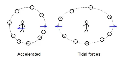

However if the sphere of particles moves with respect to you then your frame is non-inertial because it's accelerating. Finally if the sphere of particles changes shape then the frame is non-inertial because there are tidal forces acting.

Incidentally, if you look more closely at the falling elevator frame in your question (1) you'll realise it isn't inertial either. The acceleration due to gravity changes with distance from the centre of the Earth, so the test masses nearer the centre will accelerate slightly faster while the ones farther from the centre of the Earth will accelerate slightly slower. The result is that your sphere of test particles changes shape and gets stretched out into an oval. This is an example of tidal forces.
However if the size of your test sphere is small the tidal forces will be small. If we make the radius of the sphere really tiny the tidal forces will be undetectably small. This is what we mean by locally inertial - the frame looks inertial if we consider a small enough region of it.
