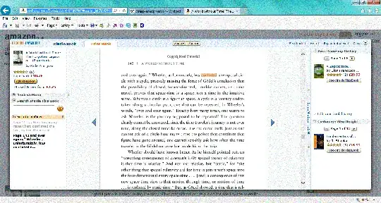

Don't think this is just something I've made up. Check out A World Without Time: The Forgotten Legacy of Gödel and Einstein. See this page in it, where author Palle Yourgrau says Wheeler conflated a circle with a cycle, precisely missing the force of Gödel's conclusion:
He's right. You don't move round that closed timelike curve. And there is no way you can move such that everything else in this universe not only moved back to where it was, but never moved at all. Time travel is a fantasy I'm afraid. And so are closed timelike curves.
