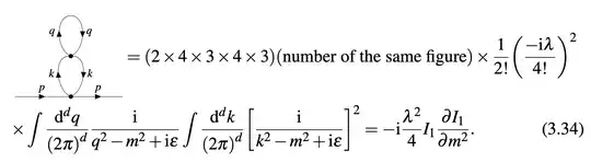

As far as I know, I think you mean this diagram, enter image description here

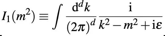

where, enter image description here
And the divergent part of $I_1$ is $I_1^{\text{div}}=-\frac{m^2}{8\pi^2\epsilon}$, where $\epsilon$ is from $d=4-\epsilon$. At least we can see that $I_1^{\text{div}}\frac{\partial I_1^{\text{div}}}{\partial m^2}$ will have a divergent term like $1/\epsilon^2$. Thus, we can see this $\_8\_$ diagram will contribute to the two-loop for the correction of mass.
