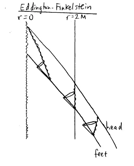

A falling observer does not experience passing through an event horizon as you describe.
Instead a free-falling observer would see space-time as locally flat as long as the tidal forces were manageable. Your head and your feet are (nearly) sharing the same frame of reference.
The falling observer always sees the apparent horizon in front of them until they reach the singularity in a finite proper time.
Up to that point, as Mike correctly describes, because no stationary "shell" observers are allowed, and space itself moves towards the singularity, it is possible for both the following statements to be true.
  1. Light directed outwards still travels at the speed of light outwards according to the falling observer.
  2. That light will always end up at the singularity in the future, but after the observer gets there.
I find the following diagram helpful. It shows the world lines of head and feet in Eddington Finkelstein coordinates and I obtained it here. In this diagram the singularity and the event horizon are shown as vertical lines. The curved solid lines are the world lines of your head and feet respectively. Light cones are shown and these are limited by the trajectories of light directed radially inwards or outwards. Far from the black hole these would just be lines at $\pm 45^{\circ}$. At the event horizon the outgoing side of the light cone is vertical. Inside the event horizon we see that the future light cone is directed inwards and that nothing can escape to outside the event horizon.
Now follow what happens when the "feet" signal to the "head" by following the world line of an outging photon (the right hand side of the light cone). You can see that a signal from the feet is always able to reach the head right up until the head meets the singularity. But of course that outgoing signal never makes it out of the black hole, it too reaches the singularity sometime after the "head" does.
Head and feet in Eddington-Finkelstein coordinates
