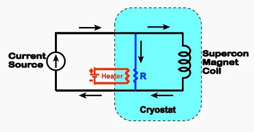

It is instructive to see how an MRI magnet is "ramped" (turned on). From that link, I reproduce a circuit diagram here:
By turning on a very small (mW) heater, you can locally heat the superconducting loop so it becomes resistive. Now you can apply a voltage to the circuit - and it will preferentially send current around the superconducting part of the loop. The current will not be infinite though - for a given inductance $L$, the magnet will "ramp" as the current increases according to $$V = -L\frac{dI}{dt}$$.
When the desired field strength is reached, you turn off the heater - the loop will be closed and the current will keep flowing. At this point you turn off the voltage (current) supply. And you have a (strong) magnet that will persist for a very long time - as the current keeps flowing without resistance.
