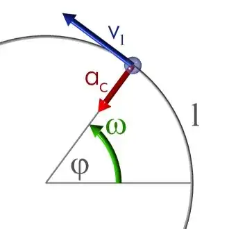

Centripetal force is the force that an object feels when is in a circular motion. enter image description here
In this picture, $a_c$ is the centripetal force, $v$ tangential velocity, and $\omega$ angular velocity.
Now, centrifugal force is the imaginary force that appears when the reference frame is in rotation.
