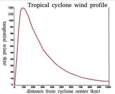

First of all, to fix our ideas, I assume that you are talking about an tangential wind profile that looks something like this:
enter image description here $\phantom{texttexttexttexttexttexttexttexttextte}$
The plot shows the (azimuthally averaged, i.e. averaged along circles) tangential wind profile as a function of radius at a fixed height. Looking at this picture one is naturally reminded of a Rakine vortex, which consists of a forced vortex core surrounded by a free vortex. You said:
[...] a forced vortex has a velocity profile u∝r (r is radial distance from centre of vortex), concluding at some outer boundary r=R to avoid fluid particles travelling at infinite speed. At this outer boundary it requires an external torque to be constantly supplied to keep going.
The misconception here is that in a tropical cyclone, there is no solid (nor an effectively solid) boundary at the point where the "forced" vortex transitions into the "free" part. There is no wall that imparts momentum to the fluid by wall friction as in the cylinder.

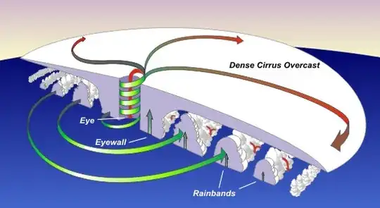

The Rankine vortex model (just like free and forced vortex models individually) describes an axis-symmetric vortex in a two-dimensional fluid (all motion occurs in the horizontal plane and motion is independent of z). A real tropical cyclone is neither exactly symmetric and, more importantly, it is very much a three-dimensional flow structure. Before I go on, let me just say a few words about what that structure looks like:
enter image description here $\phantom{texttettexttextte}$
Due to the low pressure in the centre of the cyclone, the air is set in circling motion according to (1). However, there is a layer close to the surface called 'planetary boundary layer' where the balance (1) is broken by frictional effects. Here, the flow is no longer along constant radius but has a component pointing from high to low pressure (i.e. a radial component). The air masses converge in the centre of the cyclone and hence are forced (by mass conservation) to move upward in the so-called eyewall. As the air rises, water vapour condenses releasing latent heat and giving the air parcels further buoyancy so they can keep rising up to the tropopause. this illustrates the fact that the three-dimensionality along with thermodynamic effects make the cyclone a more complicated problem than the theoretical forced or free vortices.
