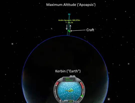

Typically the goal of a satellite is to orbit, and thus as the other answers address, you must build significant horizontal velocity. Indeed if the Earth didn't have an atmosphere, you could orbit a few km above the surface, so the main goal is building enough orbital (horizontal) velocity somewhat above the dense regions of the atmosphere.
If you only burned vertically with respect to the Earth, you will follow a trajectory similar to the one below:
Straight Up Trajectory
I did want to add why you might WANT to travel 'vertically' only:
  1. Your goal is to smash into something that is in orbit; you just want to reach a desired altitude at a given time (say, to destroy a satellite or an orbiting alien craft)
  2. You want to crash land back on earth, say for Kinetic Bombardment ("Rods from The Gods")
  3. You want to smash into other celestial bodies. In theory, the lowest energy trajectory to lunar bombardment is to launch 'straight up' at the right time to just beyond the Earth-Moon L1 Lagrange Point.
To get to the moon (well, smash into or flyby the moon), for example, you could 'launch straight up' and follow a trajectory like the one below. Note that you will have some horizontal velocity if you 'launch straight up', as you will inherit the rotational velocity at the surface depending on your launch site's latitude (~500 m/s at the equator, 0 m/s at the poles).
Lunar Flyby
In the above scenario, I was a bit late on the launch timing and thus trailed behind the Mun (in game 'Moon'). The purple post-encounter trajectory would have landed me back onto the surface of the planet, with no stable orbit established, and launched from the equivalent of the equator.
Bottom line is, if you want to orbit, you need horizontal and (and initially some vertical) velocity with respect to the surface. You can save a bit of fuel if you just want to 'get there' (and then smash into something).
