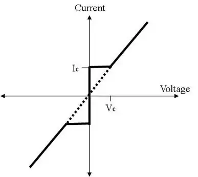

According to the $I$-$V$ curve for Josephson junction tunneling for S-I-S (superconductor-insulator-superconductor),
Do we have any tunneling current for $0< V\leq V_c$? If yes, then why don't we show it in the diagram? If no, why don't we have a tunneling current in this voltage interval?

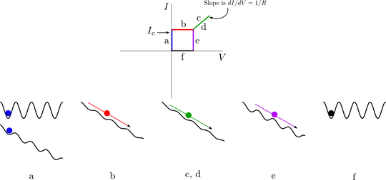

The IV curve
The potential energy term is the key to understanding the IV curve. Please refer to Figure 2 when reading the following description.
Figure 2: The IV curve and illustration of the junction speudoparticle for a sequence of current biases.
At $I=0$ the junction experiences a cosine potential. In this case, it sits trapped in one of the wells of the cosine, as indicated in Figure 2 a. As we turn up the current we introduce the linear term to the potential. If the bias current is less than $I_c$ there are still minima in the potential and the junction remains trapped as indicated also in Figure 2 a. Because the junction is trapped at a fixed value of $\delta$, the voltage is zero (recall $V \propto \dot{\delta}$). This is the part of the IV curve wherein we increase the current without increasing the voltage, as indicated in the horizontal blue line marked $a$ in Figure 2. Note that at this stage all of the current flows through the tunnel element and none flows through the resistor.
As we increase the bias current past $I_c$, the linear term in the potential overtakes the cosine part and the minima disappear. The junction then "rolls down hill" as shown in Figure 2 b. Because we now have a time varying phase, the junction voltage rises from zero to a finite value, as indicated by the red line marked $b$ in Figure 2.
At this stage, $I$ exceeds the critical current of the tunneling element and so the tunneling element no longer behaves as a superconductor. Quasiparticles are generated, rendering the junction resistive. Further increases in current show an accompanying linear increase in voltage according to $V = IR$, as shown in Figure 2 c, and by the green line marked $c$.
As we lower the current we travel back down the green line, as indicated by the mark $d$.
The rest of the process depends on how fast we are raising and lowering the current. As we lower the current below $I_c$, the potential regains its cosine nature and has minima. If there were no dissipation (or we're sweeping fast enough that whatever dissipation there is can't completely stop the particle during the sweep) the "particle" would continue to "roll" because it already has kinetic energy. Therefore, even as $I$ is lowered below $I_c$ we still have time varying $\delta$ and therefore still have a measured voltage. This is shown in Figure 2 e and the magenta line marked $e$.
Finally, when we get back to zero bias, the cosine is flat and as we sweep back toward negative bias we slow down and finally stop the particle. Then as we increase the negative bias the process starts all over in reverse.
Remarks
If you look closely at the IV curve in the original post you see that it's not a true square as shown in Figure 2 of this answer. This has to do with the detailed dynamics of the junction during the time dependent sweep. The damping of the junction and the sweep rate of the current bias play important roles in the shape of the IV curve.
In any case, we have shown that the vertical line at $V=0$ on the oscilloscope trace, which corresponds to the blue line in Figure 2 of this answer, comes exactly during the condition when there is zero voltage but a nonzero tunneling current.

I think there is still a current flowing. I found this picture enter image description here
on this website. The gist is that above a certain voltage $V_c=2E_g/e$ (twice the energy gap divided by elementary charge), the voltage large enough to overcome the band gap and Cooper pairs can flow.
