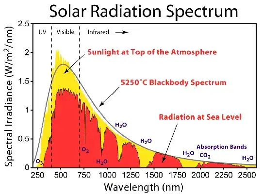

The solar spectrum looks like the image below. The yellow shaded curve is the observed spectrum at the top of the atmosphere while the red curve is what we get at ground level. The black line is a blackbody model of the sun (a pretty good approximation, just don't worry about the yellow curve peaking above the black line)
(source)
940 nm occurs right around the first H$_2$O valley (where some of the sunlight is absorbed by water in the atmosphere). So while this wavelength will be reduced in intensity (as compared to 1000 nm), your device will likely still observe some background IR.
