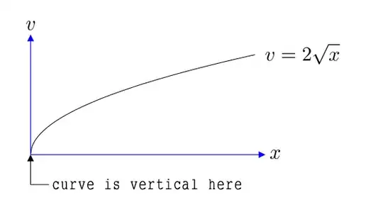

Let us consider the case where speed is this function of distance, $v(x) = 2 \sqrt{x}$, where the expansion of $ a= v \frac{ {\rm d}v }{ {\rm d}x }$ applies:
Then $$ \frac{ {\rm d}v }{ {\rm d}x } = \frac{1}{\sqrt{x}} $$
and
$$ a = v\,\frac{ {\rm d}v }{ {\rm d}x } = 1 $$
But when $x=0$ you clearly have $v=0$ and $a>0$
What is going on here is that often when $v \rightarrow 0$, then $\frac{ {\rm d}v }{ {\rm d}x } \rightarrow \frac{1}{0}$
You can interpret this geometrically in a $v$ vs $x$ graph. When $v \rightarrow 0$ the distance $x$ does not change and the curve looks like a vertical line at that time.
