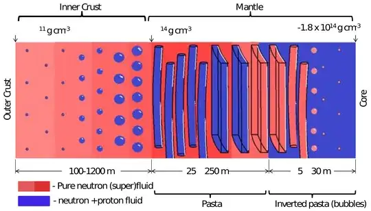

Above densities of $\simeq 3\times10^{16}$ kg m$^{-3}$, nuclei probably start to lose their separate identities and spherical nature, forming elongated rods or planes of nuclear material -- nuclear pasta. Initially the nuclei are thought to group into "spaghetti" and then into "lasagna", where the sauce is provided by the gaseous free neutrons. As densities exceed $10^{17}$ kg m$^{-3}$, it is thought these roles reverse; the gaseous neutrons form into spaghetti like structures surrounded by nuclear material and then finally, shortly before dissolution, the crust consists of nuclear material enclosing spherical bubbles of neutron gas.
Here is a schematic picture, due to Newton et al. (2011) that shows how the pasta phases develop with increasing density. As I show in some more detail below, the departure from an ordered lattice of spherical nuclei is expected to occur when the nuclei fill more than abut 1/10 of the volume.
Schematic of nuclear pasta
