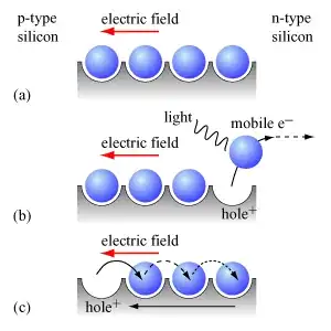

You can identically consider the flow of electrical charge as either the movement of a negative electron from left to right, or the movement of the empty place an electron would be from right to left. If you think in terms of the movements of the gaps (holes) then you have a positive current flowing which matches the normal definition of electrical current.

If electrons are negatively-charged, what is this "positively charged particle" that flows in a circuit? It is not a real particle - there is no positively charged particle flowing in the circuit (the protons stay relatively still). Rather, the "positive charge" is really a lack of negative-charge - an empty space with higher electric-potential, which the electrons are necessarily attracted towards.
(Electrons moving to the right necessarily cause holes to flow to the left)
Electron holes are not a real "thing" - they are just a concept used to help explain why it doesn't matter (to electrical engineers) whether it is a positive- or negative-charge flowing, and to help them cope with the fact that all their diagrams use the "wrong" charge-carrier :)
See this blog post for more info on this (and other good electricity-related questions).
Yes, they are positive.The hole is the absence of electron(hole is not a particle but a vacancy) According to quantum mechanics anything that can have a wave function, a probability amplitude for being at different locations is a particle, so we assume that hole is a particle because it satisfies the definition of a particle according to Quantum Mechanics. When a hole is created in a crystal the neighbouring electrons can move into that vacancy and fill it up.Similar to the analogy of an air bubble in water, the bubble doesn't move, the water surrounding it moves.So the hole current is nothing but the flow of electrons(but a lot slower)...the term hole is created to simplify some of the various concepts of semiconductor physics.It is an assumption to make things simpler.
