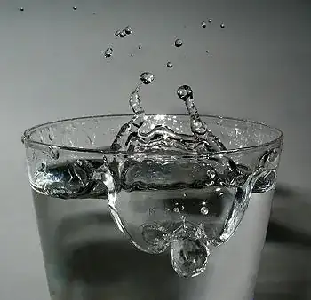

When a drop of water falls into a reservoir of water from a high enough altitude, water droplets will splash (image credit):
My question: Does the water in those droplets come from the original drop or from the reservoir?

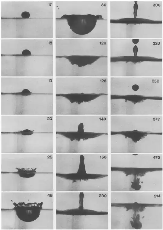

In order to determine whether the original drop is present in the 'recoiled' water, a series of photos were taken at successive time intervals 0.0003s apart, using a 4.83mm diameter drop (with coloured dye) dropped from a height of 175mm into a transparent pool of water. The number in the corner of each photo represents the sequence number of the photo (at 0.0003s intervals).
As can be seen from these photos, the colour dye is present in the water jets which recoil off the surface of the transparent pool water. However, not all of the water in the jets is from the coloured drop. Some of the original drop is trapped in a pocket below the surface, with the rebounding 'jets' having a 'coating' of the original drop material. The way we know this is because in the experiment, the coloured drop was made from water mixed with thymol blue, an indicator which is dark orange in colour at neutral-to-acidic pH. The pool water contained 0.1% sodium carbonate (alkali), which is transparent in colour, but when the two combined, the mixture turns blue in colour.

When the drop enters the water it pushes water in the reservoir out of it's way (this action uses up the energy of the drop, causing it to slow down and stop). When the drop has passed it leaves air behind it (a slip-stream effect). The reservoir water bordering this slipstream then moves from all sides to fill in the gap. When the water from opposite sides meet in the middle it must dissipate the energy in the collision. It cannot move to the sides or down, because there is water already there, so it 'bounces' up instead.
In the picture, one can see the original drop at the bottom of the disturbed water and the 'slipstream' above it.
