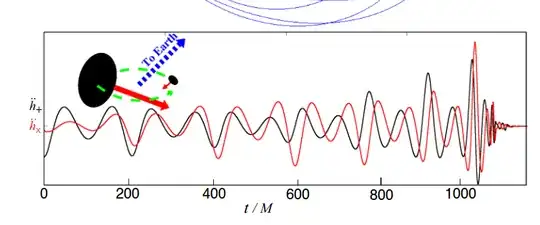

Thorne's notes also show the predicted signal LIGO should make, enter image description here
which looks remarkably like the real signal real signal
(source)
