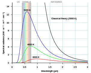

Black body radiation was one of the first indications that electromagnetic energy is quantized.
blackbody
As the temperature decreases, the peak of the black-body radiation curve moves to lower intensities and longer wavelengths. The black-body radiation graph is also compared with the classical model of Rayleigh and Jeans.
Classical electromagnetic theory which wanted the radiation emitted by a body at a specific temperature to be continuous had the so called ultraviolet catastrophe, the curve on the right. Data did not follow the classical distribution. Planck's law that required that electromagnetic radiation comes in packets called photons, (quanta of energy, E=h*nu,) i.e. that the molecules would not radiate in the continuum but from specific levels, described the data as seen in experiments. This youtube video has an experiment and some curves at 6:46.
The theoretical curve is calculated assuming a metal cavity where these quanta bounced around and then one looked at a small hole to see what comes out. A black body is a body that contains the radiation coming from the molecular energy levels and radiates it from the surface . Real bodies have constants modifying the formula, but the basic idea holds.
