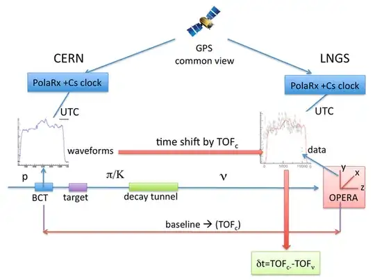

Location errors and clocks drifts
The arXiv paper studied them, and seem to exclude it. The distance seems to be known within 20 cm and the synchronisation seems to be within 15 ns (6.9 statistical and 7.4 systematic). If this would however end up to be the explanation, it would be quite boring.

The setup of CERN and OPERA is conceptually very simple, basically just two observers located a known distance apart with synchronized clocks. It's a direct measurement of average velocity. There's no complicated theoretical analysis that needs to be done to determine whether the speed of light was exceeded. Either they are wrong about either the distance (mismeasurement, or there is a spacetime "rift" within the Earth :-P) or the time (clock synchronization error or drift), or they have actually discovered superluminal neutrinos.
